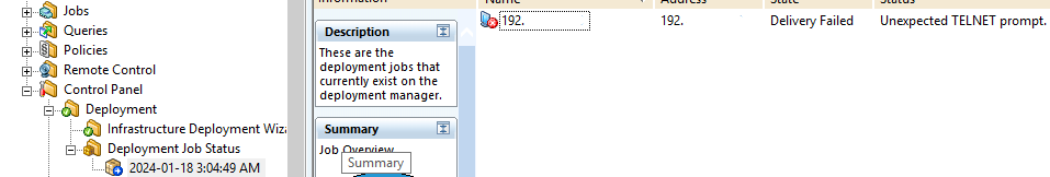

When using deployment wizard to install agent remotely to Red Hat Enterprise Linux release 8.1 (or higher version like 8.2, 8.3 etc...), it fails with error "Unexpected TELNET prompt."
