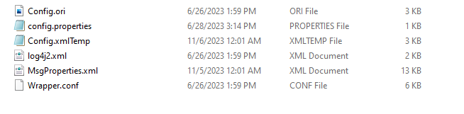

This error indicates that file C:\Program Files (x86)\CA\SC\CIC\conf\config.xml could not be found
- Check in directory C:\Program Files (x86)\CA\SC\CIC\conf if there is a copy of file config.xml
Example : in the screenshot below there is a copy of config.xml with name config.xmlTemp
- Rename the copy with filename config.xml
If there is no copy of file config.xml, restore it from a backup.
