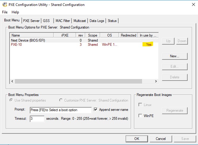

Can't delete preboot configurations as the 'In use by ...' says 'Yes'.
Need an easy way to identify which jobs are using which preboot configurations

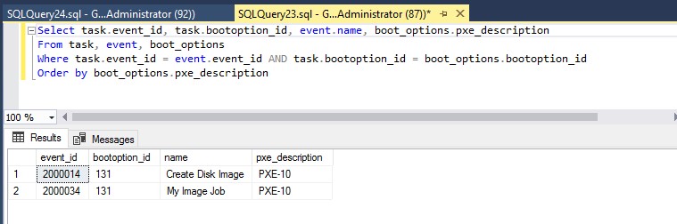

  1. The following SQL can be used to identify which jobs are using which preboot configuration:
    Select task.event_id, task.bootoption_id, event.name, boot_options.pxe_description
    From task, event, boot_options
    Where task.event_id = event.event_id AND task.bootoption_id = boot_options.bootoption_id
    Order by boot_options.pxe_description
