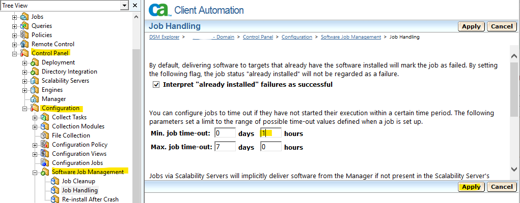

It is possible to change the minimum or maximum timeout values in DSM Explorer :
1- Open DSM Explorer and go under
Control Panel/Configuration/Software Job Management/Job Handling
2- Set the new minimum or maximum timeout value :
Example : Minimum set to 1 hour
3- Click Apply button

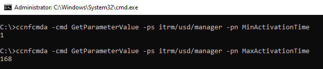

These values are stored in Domain Manager comstore under :
itrm/usd/manager/MinActivationTime
itrm/usd/manager/MaxActivationTime
and values (exprimed in number of hours) can be seen with :
ccnfcmda -cmd GetParameterValue -ps itrm/usd/manager -pn MinActivationTime
ccnfcmda -cmd GetParameterValue -ps itrm/usd/manager -pn MaxActivationTime
