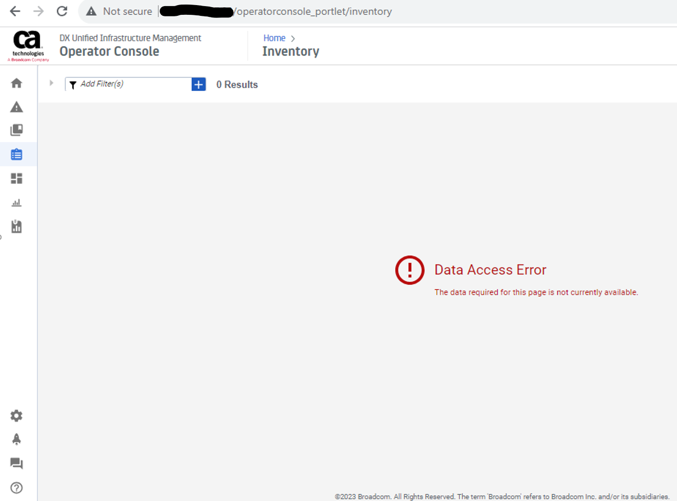

After upgrading to CU8/9 from UIM 20.4 CU7, there may be several issues observed:
Data Access Error in the Inventory of Operator Console (OC):

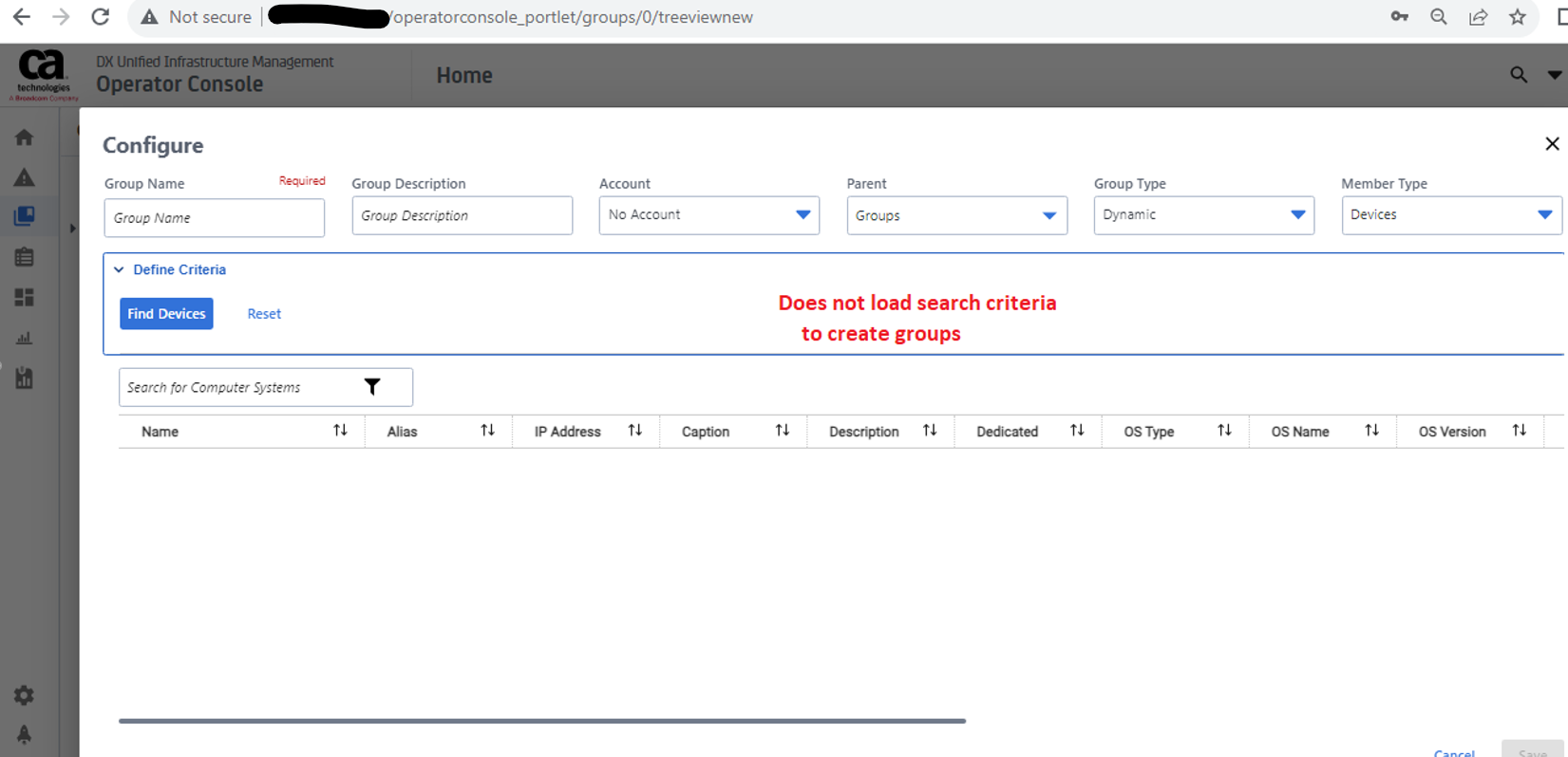

No data is found in group and groups are not able to be created:
  • UIM 20.4 CU8/9
  • OC 20.4 CU8/9
  • Defect found in the sql queries used that may cause this issue in some environments.
The customer updated to UIM 20.4.9 (CU9) on the UIM Server and OC.
In addition, they installed the hotfixes related to the defect -> DE576152 on the OC Server, which resolved the problem.
