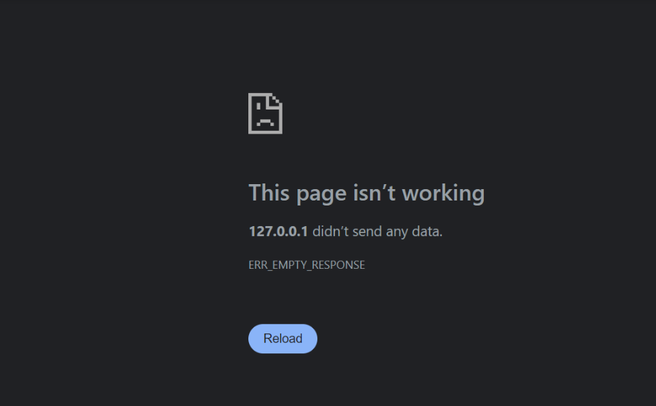

When trying to open the Software Portal page (from the agent system tray icon >right-click>Software Portal)
while in CEM (Cloud-enabled Management) mode, the following error message appears in the internet browser:
This page isn't working
127.0.0.1 didn't send any data.
ERR_EMPTY_RESPONSE
Or page would block with 403 error:
The link is trying to access is something like this:
"http://127.0.0.1:59100/altiris/softwareportal/portal/?MachineGuid={xxxxxxxx-8D45-454B-xxxx-5C2xxxxxx21B}&MachineName=Laptop-64x12345&Platform=Win64"
