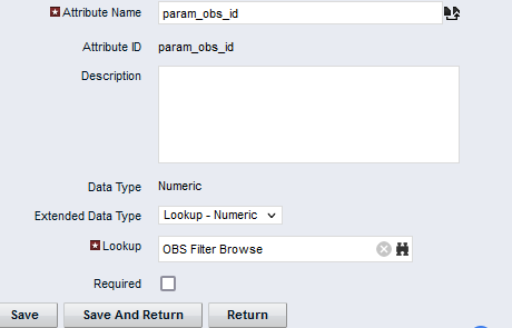

Click the Attributes tab and click on the: param_obs_id
Set extended Data Type = Lookup - Numberic
Set Lookup = OBS Filter Browse (OBS_BROWSE_FLT_ALL)

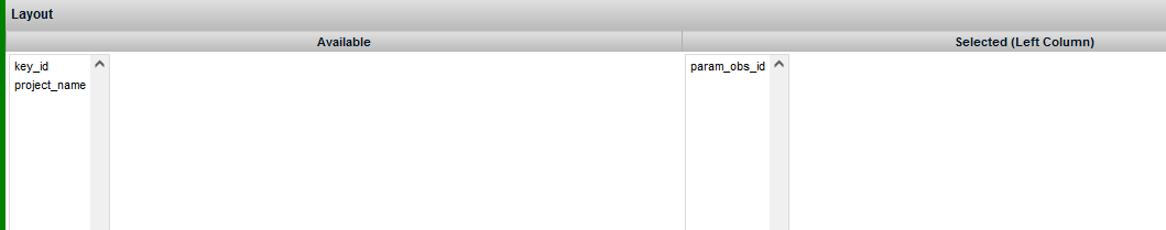

3. Configure the List  Filter > Layout  section inlcude : param_obs_id
Save and Return.
