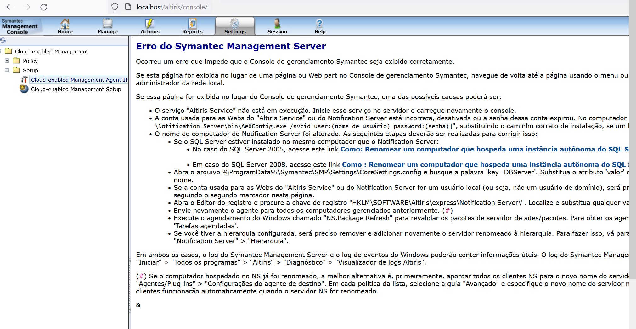

While going to the Cloud-enabled Management Agent IIS Website Settings page (SMP Console under Settings>Notification Server>Cloud-enabled Management>Setup), the page is not loading. Getting a generic error page:

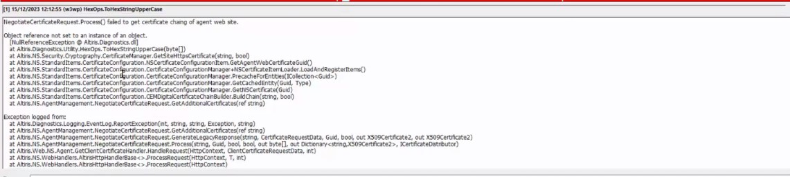

The NS logs show messages like:
Entry 1:
HTTP Request failed: /Altiris/NS/Admin/Configuration/CertificateManagementPage.aspx
Object reference not set to an instance of an object.
Entry 2:
NegotiateCertificateRequest.Process() failed to get certificate chaing of agent web site.
