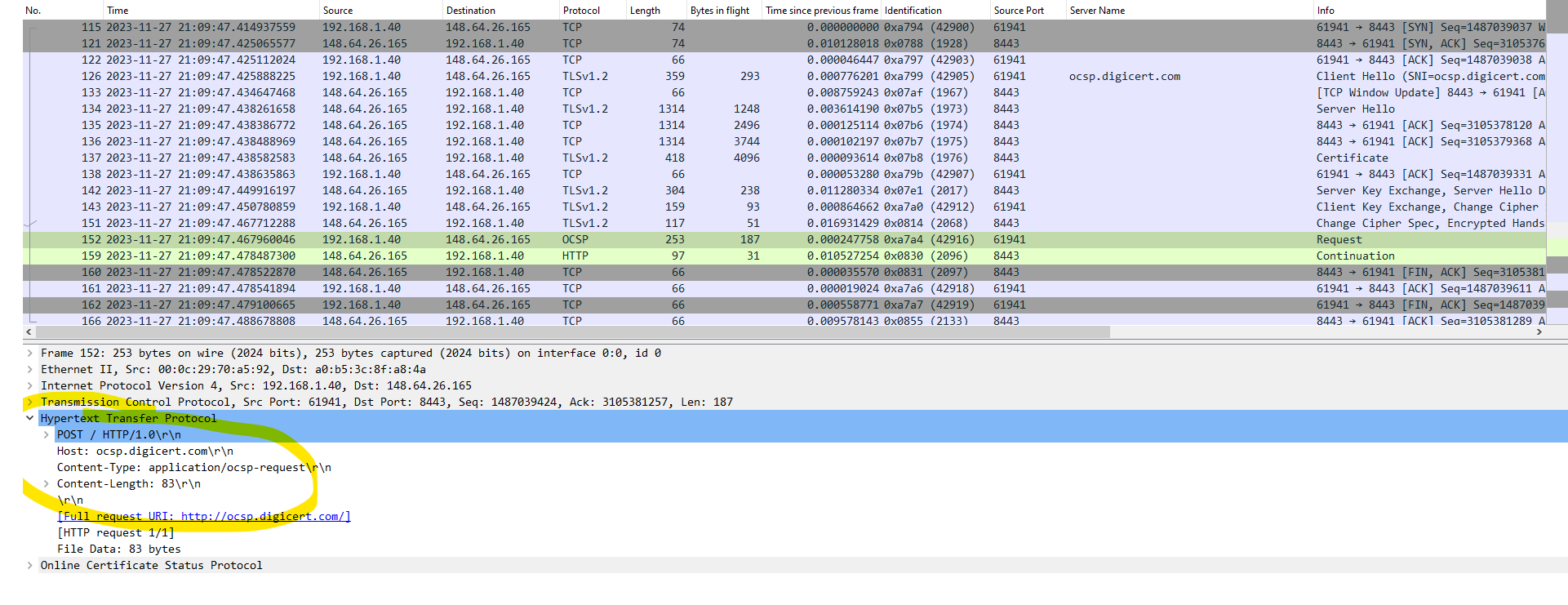

OCSP validation on the Edge Proxy generating a NON explicit request into Cloud Proxy that is setup to handle explicit requests.

When OCSP validation is performed on the Edge Proxy, it must validate all certificates in the chain including the intermediate/root certificates. Seeing a reference (AIA attribute from intermediate certificate in our case) to an an OCSP server, the Edge proxy generates the OCSP request to the defined OCSP host and expects to receive a successful response. These OCSP validation requests are typically over HTTP and hence go to TCP 8443 on Cloud Proxy.
In our case, the successful OCSP response did not come back over TCP 8443, resulting in the SSL error reported.
Looking at the request in more detail, we see that this HTTP request is not explicit in nature but transparent - an explicit request would include the username and path in the POST request as shown below:
