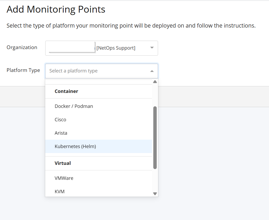

Step 1 - request the monitoring point files as usual
(Monitoring Points > Add Monitoring Point > Azure Kubernetes (AKS) - you'll need to download and unpack this to get the values.appneta.yaml file for step 2
In the setup.sh file, you'll find all the details like helm repo and relevant commands. From there you should be able to pull what you need along with our helm chart location that you can pull into your environment. For example you could try the following:
