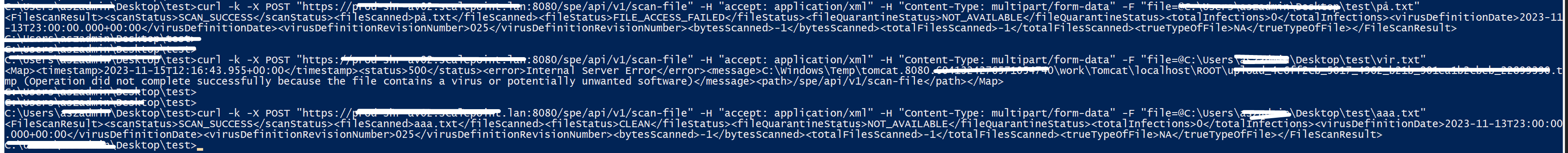

"{"scanStatus":"SCAN_SUCCESS","fileScanned":"på.txt","fileStatus":"FILE_ACCESS_FAILED","fileQuarantineStatus":"NOT_AVAILABLE","totalInfections":0,"virusDefinitionDate":"2023-11-08T23:00:00.000+00:00","virusDefinitionRevisionNumber":"025","bytesScanned":-1,"totalFilesScanned":-1,"trueTypeOfFile":"NA"}"
copy the files locally and scan them using the command shown in the attached capture below:
The same result when trying to scan using cmdline tool included in scan engine folder of SPE direcotry:
C:\Program Files\Symantec\Scan Engine\CmdLineScanner\C>ssecls.exe pąpä.txt
"papä.txt" file or directory does not exists.

Scanning a file with a file name having Polish characters works fine, check the below screenshot for your reference.
UTF8 is not enabled, as a result, scanning of files with Unicode fails. Please follow the below steps to enable UTF-8 in your SPE scanner machine:
Go to the "Region" settings of the Windows machine, and follow the numbers highlighted in the screenshot below to enable UTF-8 and then restart the system, and then try scanning files with files having polish characters.
The result from cmdline testing locally from the SPE server will be also successful:
C:\Program Files\Symantec\Scan Engine\CmdLineScanner\C>ssecls.exe ppä.txt
