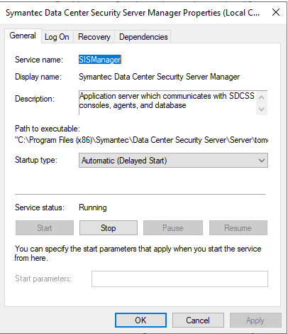

In order to mitigate for this potential issue, consider setting the following services from the Microsoft Services (services.msc) to "Automatic (Delayed Start)"...
  • Symantec Data Center Security Server Manager
  • Symantec UMC Credential Service
  • Symantec UMC Telemetry Service
For example:
Note: This mode means the service will start after a short wait for other Windows services marked as Automatic.

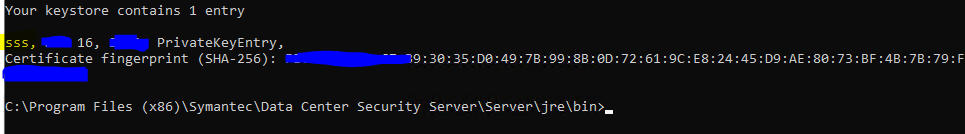

  5. Use the Java keytool.exe command-line (CLI) tool to identify CA (issuer) certifciate file(s) from the sss.ssl keystore, using a command like:
    C:\Program Files (x86)\Symantec\Data Center Security Server\Server\jre\bin>keytool.exe -keystore "C:\Example\sss.ssl" -storepass "CdlxmLPSnCng65ttkeXXXtWhAS4fIlfuRlanOXxc" -storetype PKCS12 -list
  6. Take note of the keystore alias name.  It can be identified by either "sss" (which is the default installation alias) or any single-line value after "Your keystore contains 1 entry" before the following "," (comma) and date.
    For example:
    Note: In the above example the alias entry is "sss". If a thirdparty or in-house issued certificate is used, the alias may be autogenerated by the issuer.
