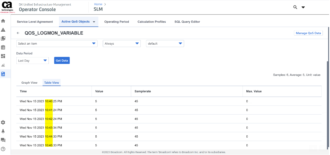

logmon 4.21 now has a built-in scheduler feature. Schedules can be created and applied to specific profiles.
Using a logmon schedule you can control when monitoring is in effect and when alarms are generated, e.g., within the desired scheduled day/days and time period, e.g., 21:15 to 21:20 (see alarm 'Time Received' in the alarm screenshot farther below).
The test schedule above was set to Wednesday, 21:15 to 21:20. Note that this is based on the system time of the machine/robot where you have logmon deployed.
The normal logmon 'check' interval can remain the same, e.g., set to every 45 seconds but the Schedule will be 'in effect' once applied to your profile. You will not receive an alarm outside of the Schedule window (as expected), when the schedule is assigned to your desired profile.
No alarms will be generated outside of the Schedule window as per test results. Schedules will work as expected within their window.
These defined schedules work for controlling when QOS is collected as well.
