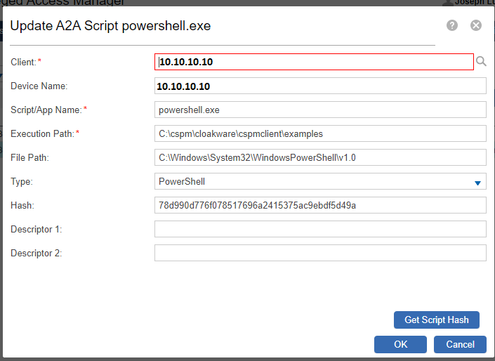

All the important information can be found in the Tomcat diagnostic logs {catalina.out} under Configuration>Diagnostics>Download Recent Log Entries.
 { targetAliasName=ps1alias, scriptName=powershell.exe, scriptFilePath=C:\Windows\System32\WindowsPowerShell\v1.0, scriptExePath=C:\cspm\cloakware\cspmclient\examples, executionUID=<My User>, requestServerHostname=10.10.10.10, clientType=java, osName=Windows 10, osVersion=10.0, osArchitecture=amd64, version=4.12.3, hash=78d990d776f078517696a2415375ac9ebdf5d49a, reason:GetScriptCredentials.invoke script authorization not found for script name.}
Configure the following based on this example
