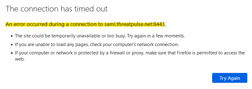

Users accessing services over IPSEC are never redirected to the SAML IDP server to login; instead they are correctly redirected to the Cloud SWG SAML SP, but get following connectivity error on the browser.
PAC file pushed down to browsers indicating traffic should be sent to Proxy at 199.19.250.205:80.
There are no firewall rules blocking TCP port 8443, and a manual telnet from the browser host to 199.19.248.205 port 8443 connects fine.
Bypassing saml.threatpulse.net domain from being proxies seems to workaround the issue.
