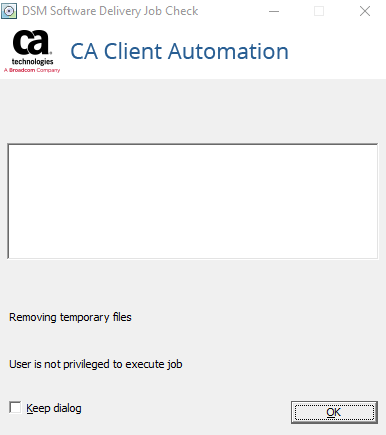

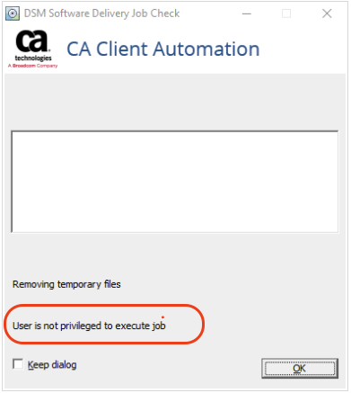

When executing a cof file, following error appears :
User is not privileged to execute job

Client Automation - All versions
The user executing the cof file does not belong to the local or global Administrator group.
Solution 1
Add the user in the local group sdofflin
Solution 2
If the user is already in Administrators group and/or in sdofflin group, following workaround could be tried :
1- Edit the cof file with notepad
2- Remove these 4 lines if the cof file has been secured
Secure=1
Hash=...
FIPSHash=...
FIPSMode=1
3- Add these 2 lines in section [Container]
UserName = <username>
DomainName =
Replace <username> by an actual user name
4- Secure again the cof file is needed
sd_acmd SecureContainer <file.cof>
Remark :
On some environments, sd_acmd has problem to retrieve the logged UserName or DomainName and these 2 entries are not added in cof file.
This generates the error "User is not privileged to execute job"
