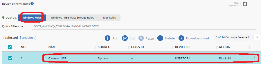

The following screenshot shows an example when the rule "General_USB" is registered in "Windows Rules".

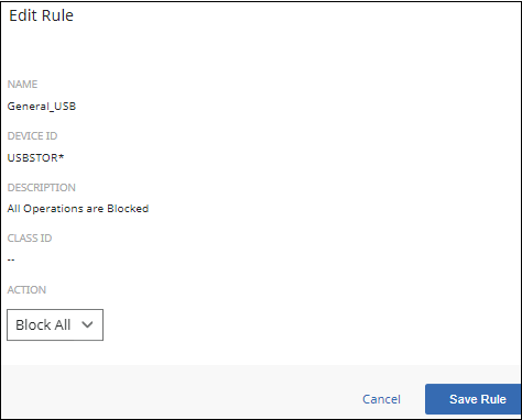

Detail of the rule
Detail of the rule

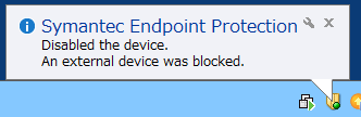

The following screenshot is an example of a notification displayed on a Windows client.

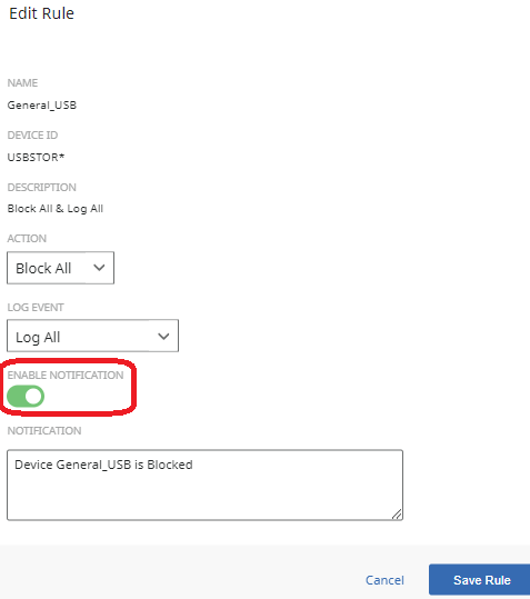

The following screenshot shows an example when the rule General_USB is registered in "Windows - USB Mass Storage Rules".
Detail of the rule
