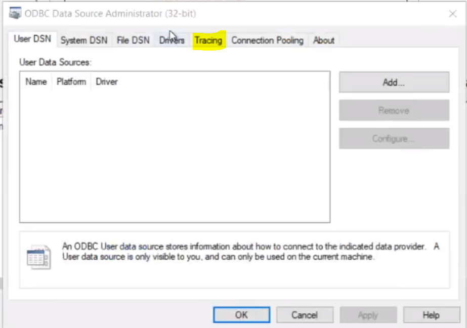

To help troubleshoot the ODBC connection failure, we enabled tracing from the ODBC Administration Utility - Tracing tab
Looking at the SQL.log that was defined in the Tracing tab, we see the following error:
DIAG [28000] [Microsoft][ODBC Driver 18 for SQL Server][SQL Server] Login failed for user <gtrep_user>. (18456)
