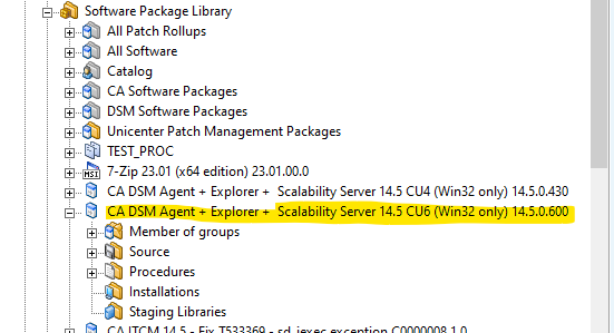

And dsmver command should diaplys a line for CU6 patch :

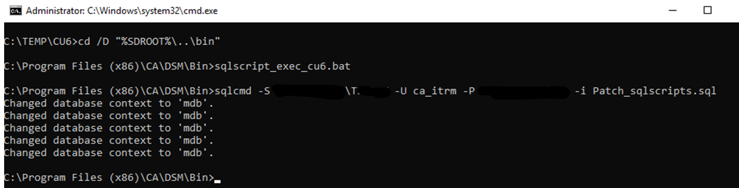

10- If it is the first CU patch installed then script sqlscript_exec_cu6.bat should be executed
 Edit file DSM\bin\sqlscript_exec_cu6.bat with notepad and update the line with SQL Server Name and Instance and password for ca_itrm user :
 sqlcmd -S Servername\instancename -U ca_itrm -P password -i Patch_sqlscripts.sql
 Example :
sqlcmd -S JY-2019-145\TESTJY -U ca_itrm -P NOT_changedR11 -i Patch_sqlscripts.sql
Open a cmd and execute :
cd /D "%SDROOT%\..\bin"
