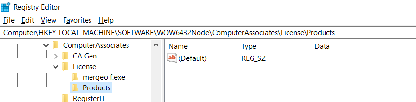

In this particular scenario, it was found that some of the required CA ALP License software registry settings "InstallPath" and "InstallPathNew" under key "Computer\HKEY_LOCAL_MACHINE\SOFTWARE\WOW6432Node\ComputerAssociates\License" had been lost.
The software itself was still present in the directory "C:\Program Files (x86)\CA\SharedComponents\CA_LIC".
On a working maachine the registry key "Computer\HKEY_LOCAL_MACHINE\SOFTWARE\WOW6432Node\ComputerAssociates\License" should be visible as follows when using a utility like regedit.exe:
The values for "InstallPath" and "InstallPathNew" were added back to resolve the problem.
"InstallPath"="C:\\Program Files (x86)\\CA\\SharedComponents\\CA_LIC\\"
"InstallPathNew"="C:\\Program Files (x86)\\CA\\SharedComponents\\CA_LIC\\"
