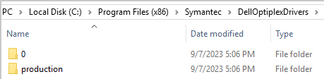

  2. Once downloaded, create a folder to extract the driver files from the downloaded .exe (or compressed file). In this example, we created a folder called 'DellOptiplexDrivers' in \Program Files (x86)\Symantec\ and extracted there:
