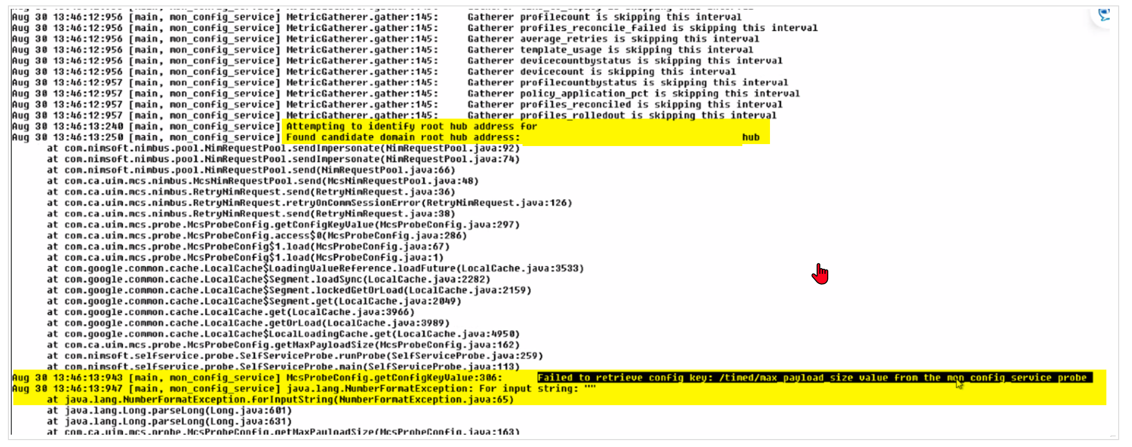

Post upgrade to 20.4, mon_config_service probe gets a pid but no port. Redeploying from scratch after delting the prone and folder makes no difference, it wil not start up.
McsProbeConfig.getConfigValue:306: Failed to retrieve config key: timed/max_payload_size value from the mon_config_service probe
The config key does exist. Once this point is reached, nothing else is written to the log and the probe just sits there with a PID and no port.
main, mon_config_service] java.lang.NumberFormatException: For input string: ""

mon_config_service could not get a port and threw a somewhat misleading error in the log, but basically it was finding/defaulting to the wrong (old) hub and as a result could not finish its startup routine due to inability to 'get' config and find/fetch max_payload_size parm value, even though it was present in the cfg, sample log extracts below:
[main, mon_config_service] RetryNimRequest.retryOnCommSessionError:99: Detected session error sending request. Received status (4) on response (for sendRcv) for cmd = 'probe_config_get' name = 'mon_config_service' Code 4
and
[main, mon_config_service] McsProbeConfig.getConfigKeyValue:306: Failed to retrieve config key: /timed/max_payload_size value from the mon_config_service probe
[main, mon_config_service] java.lang.NumberFormatException: For input string: ""
 at java.lang.NumberFormatException.forInputString(NumberFormatException.java:65)
Based on the mon_config_service log as it started up ad recognized hubs in the environment, we could see that the actual Primary hub was not identified and the probe was defaulting to use a different hubs' NimBUS address. As a result, when it was trying to run the probe callback to probe_config_get, it could NOT obtain the max_payload_size parameter and value.
