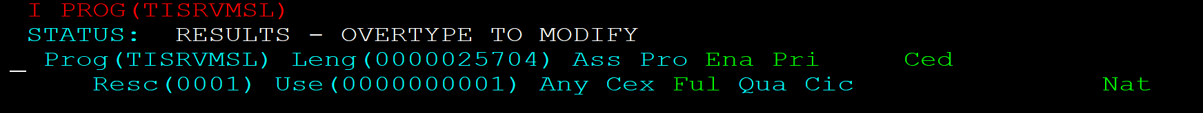

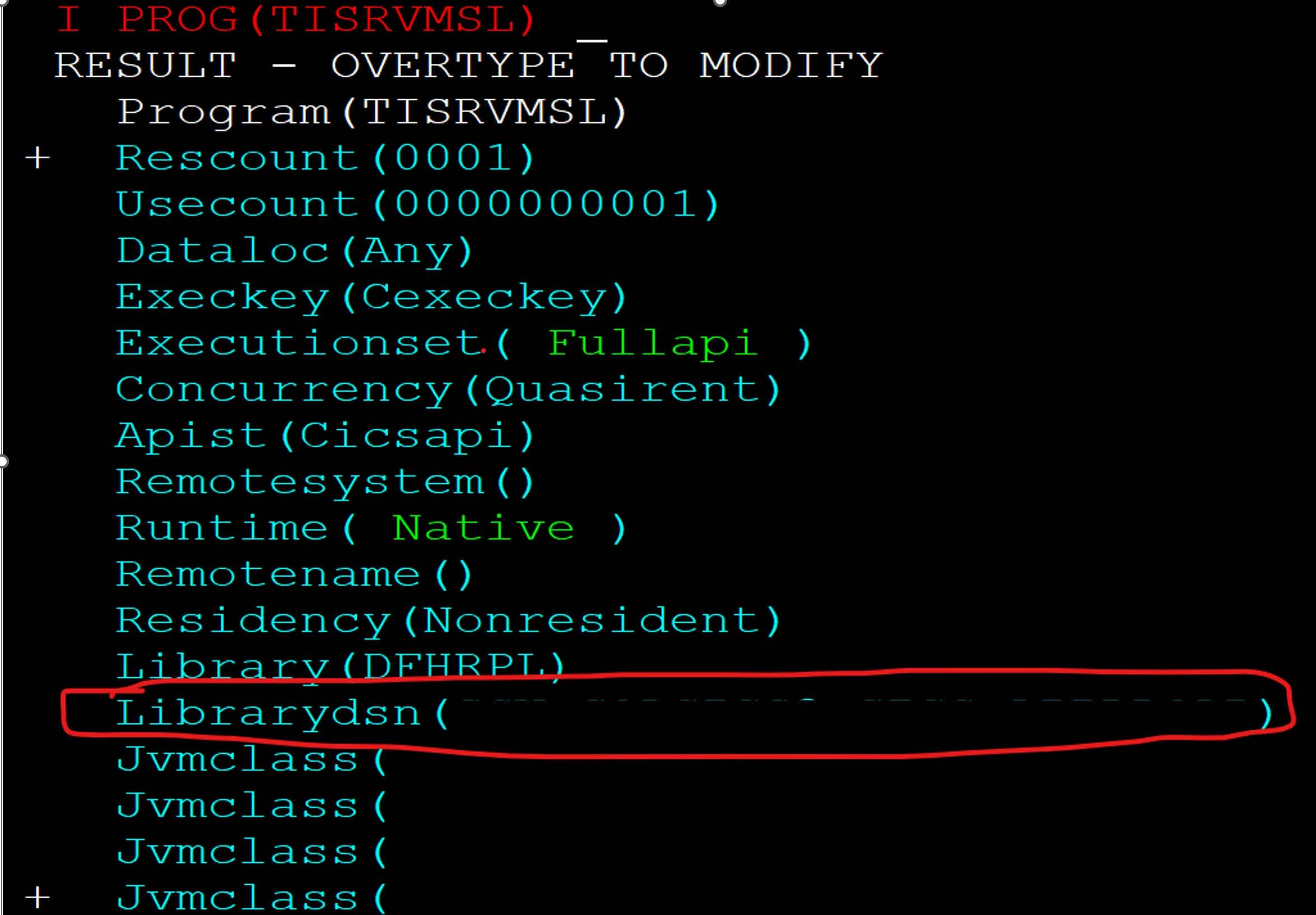

  1. Locate the relevant CICS DFHRPL library using the CICS command: CEMT I PROG(TISRVMSL)
    Put cursor beside the Prog(TISRVMSL) and hit enter; scroll and find Librarydsn  e.g.

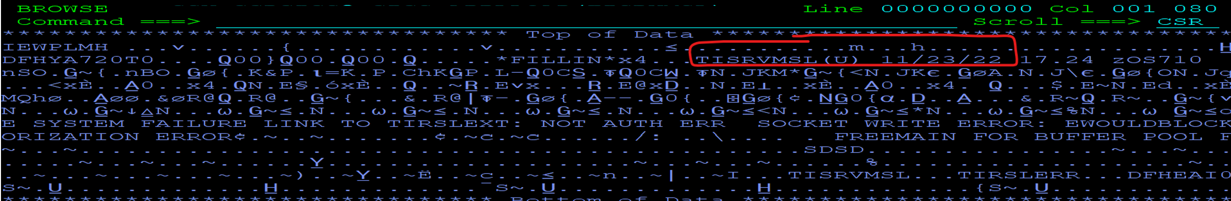

  2. In Librarydsn locate the TISRVMSL load member and browse it. Look for string TISRVMSL(U) and check the date after it. If PTF LU08295 (or later PTF containing the same fix) is applied the date should be 11/23/22 or later. For example:
