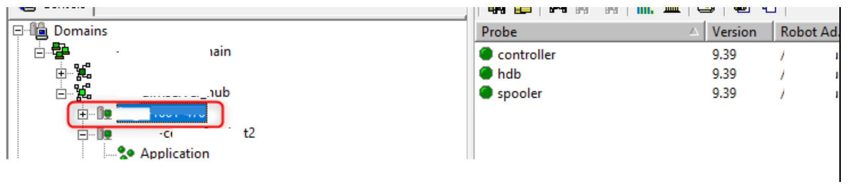

6. Finally, start the robot:
The robot will be listed under the hub:
