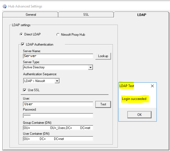

Had UIM 20.3 & noticed that LDAP stopped working (it was working about a month ago when I last logged into UIM Dev). I'm having to use the IM Administrator account for everything.
I just upgraded to 20.4 CU5 & LDAP is still not working.
The Test works & it's configured exactly the same as UIM Prod but the AD user cannot login.
The user name or password is incorrect. Letters must be typed using the correct case, Make sure the Caps Lock is not accidentally on.

hub ldap_server_login callback for login to ldap server still fails with login failed even though the hub ldap Test connection succeeds.

When we checked the LDAP Groups in the IM GUI, the same exact LDAP groups were present in both PROD and DEV.
But, for the Administrator and Operator ACLs, No LDAP Group was selected, only 'none' was selected.
Most likely the deselection was either accidental or simply temporary or mistaken selection but it wasn't reselected for each ACL afterwards - this is just a theory.
Once the proper LDAP Groups were reselected, under Manage Access Control List->Set LDAP Group, and saved, the AD user could then login again.
