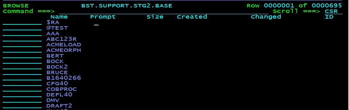

When performing scl actions like move / list etc, it was noticed that the member(s) have no attributes (size, created date, changed date, ID).
Is there any setup that needs to be done to display the member attributes or this is existing Endevor process?
e.g.
Release : All Releases
This behaviour is normal and Endevor does not populate the ISPF stats.
If there are stats on members in an Endevor controlled library, it means that the member has been updated OUTSIDE of Endevor and will most likely have corrupted the Endevor footprint of the element.
