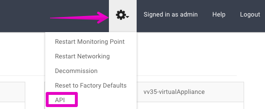

3.  Open the API:

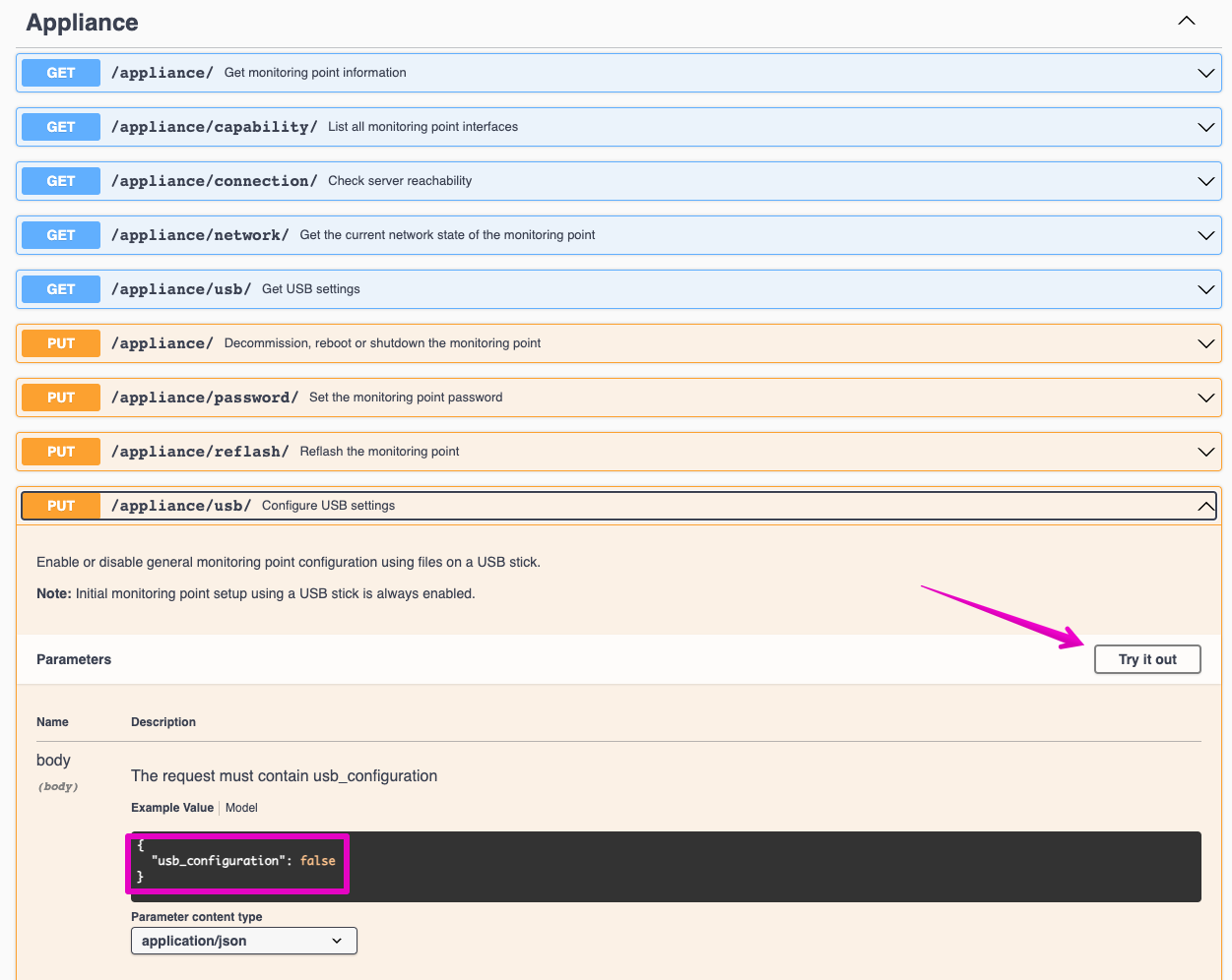

4. Navigate to the Appliance > PUT /appliance/usb.
5.  Click the Try it Out button
6.  Change the parameter -   "usb_configuration": true
This will ensure that USB can be read to configure the appliance
7.  Click the execute button below:  The Server response section should show Code "200" to confirm that the configuration was accepted.
As needed, you can change the settings back to false to reverse the change
