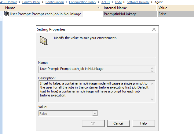

The parameter PromptInNoLinkage could be set in configuration policy :
DSM/Software Delivery/Agent/User Prompt: Prompt each job in NoLinkage

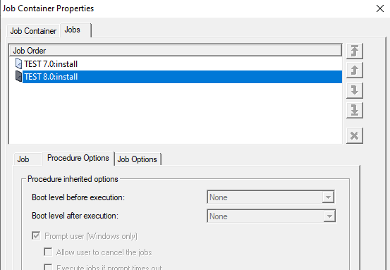

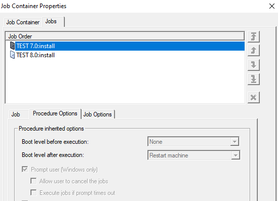

- A job container with 2 jobs are sent to a computer. Both jobs have option "Prompt User" checked.
- "Boot level after execution" is set to "Restart machine" for first job.
- The agent executes the first job and displays the user prompt.
After execution of first job, a reboot is performed.
- After the reboot the second job is not automatically executed. It asks again for the user prompt.
Why as "User Prompt: Prompt each job in NoLinkage" is set to FALSE ?
