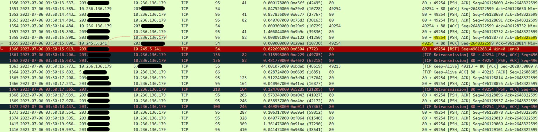

After grabbing Symdiag, we could see that requests from anydesk.exe are going to two separate IP addresses - ip.addr==5.#.#.# or ip.addr==203.#.#.#. These are public IP addresses that are used by the Application.
If we look at the PCAP snippet below, we can see that all appears to work fine for 1 min 22 secs and then in packet 1359 below, the client ACKs the data sent down from the server but using a different client IP address! Everything up to that time came from 10.236.136.179, but in packet 1359 it uses 10.245.5.241.
We can see that these 2 IP addresses are coming from the WSS Agent side from the logs there:
- One comes from the non-interactive-user System tunnel and
- on
e from the user tunnel.
What is happening is that the Application (Anydesk) is switching accounts (system or user) based on the traffic that is being sent. Although we have no control over the Application, we can fix this issue on the WSS Agent side by installing with the MCU=0 parameter (default setup). With MCU=0, we will only have one tunnel into WSS and both user and system traffic will be sent across this tunnel.

 Looking at the WSS Agent debug logs, the Anydesk query does not seem to come from a known process and, as a result, the Agent is sending it out the System tunnel.
 wss  cdq-component.cpp                    2305 StreamIdConverter                       00001998 00001BE8 6  07/06/2023-03:50:15.8908656 Info     Non-CDQ address:port seen, 203.#.#.#:80
wss  wss-connection-manager.cpp           485  SendPacket                              00001998 00001BE8 6  07/06/2023-03:50:15.8908701 Info     Sending TCP packet to a tunnel, source: 0x192.168.43.55:49254
wss  wss-connection-manager.cpp           514  SendPacket                              00001998 00001BE8 6  07/06/2023-03:50:15.8908711 Info     Checking for Service stream going to 192.168.43.55:49254
wss  identity-cache.cpp                   112  GetProcInfo                             00001998 00001BE8 6  07/06/2023-03:50:15.8908745 Err      Process information was not found for 192.168.43.55:49254
wss  identity-cache.cpp                   226  GetUserInfo                             00001998 00001BE8 6  07/06/2023-03:50:15.8908754 Warn     Couldn't find process info for 192.168.43.55:49254
wss  identity-cache.cpp                   112  GetProcInfo                             00001998 00001BE8 6  07/06/2023-03:50:15.8908770 Err      Process information was not found for 192.168.43.55:49254
wss  wss-connection-manager.cpp           573  SendPacket                              00001998 00001BE8 6  07/06/2023-03:50:15.8908793 Info     Unable to locate user info, sending 192.168.43.55:49254 from process: UNKNOWN via default tunnel
wss  packet-natter.cpp                    51   NatIdOutboundTcp                        00001998 00001BE8 6  07/06/2023-03:50:15.8908949 Info     NATting outbound TCP coming from port 49254
utl  protocol-analysis.cpp                331  CalcChecksumWithOffset                  00001998 00001BE8 6  07/06/2023-03:50:15.8908965 Info     TCP/UDP checksum of even packet size: 20
wss  packet-natter.cpp                    196  NatOutgoingPacket                       00001998 00001BE8 6  07/06/2023-03:50:15.8908985 Info     NAT: 192.168.43.55:49254->203.#.#.#:80 -to- 10.245.5.241:49254, 203.#.#.#:80
