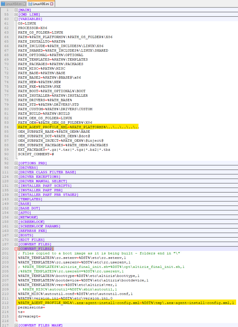

1. Modify files:
\Deployment\BDC\bootwiz\Platforms\LinuxX64.ini
\Deployment\BDC\bootwiz\Platforms\LinuxX86.ini
Add 'PATH_AGENT_PROFILE_XML=%PATH_PLATFORMS%\..\..\..\..\..' into section '[VARIABLES]', then add '%PATH_AGENT_PROFILE_XML%\.aex-agent-install-config.xml=%DST%\tmp\.aex-agent-install-config.xml,1' into section '[CONVERT_FILES2]'
