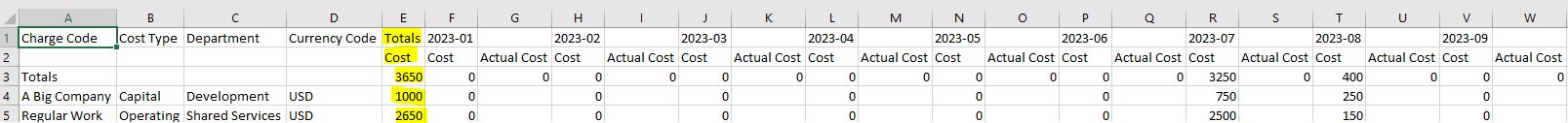

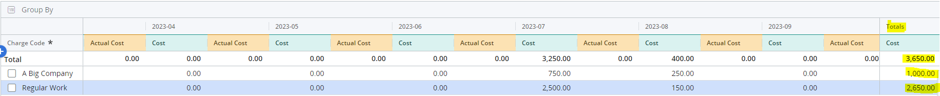

In the Cost Plan, the ordering of the "Totals" columns after exporting to CSV does not match the ordering on the screen/in my view. For example, if I have the Totals appearing on the far right in my view, the export always displays them to the far left, after the Grouping Attributes
View Layout:
Export to CSV Output, notice Totals column is on the left:

6. Totals column will be on the far left side versus the right side as dislayed in UI.
Expected Results: Totals column should be on the right side as displayed in UI.
Actual Results: Totals column is on the left side.
