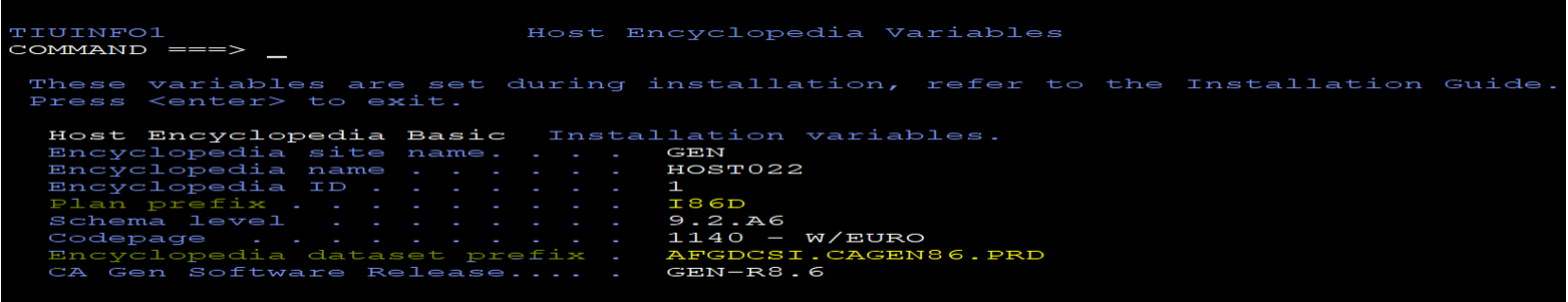

This information is displayed in the Environment Specification – Display System Information panel – option 5.5 from Main Menu:
Select option 1 for Host Encyclopedia Variables to determine the plan prefix and encyclopedia dataset prefix:

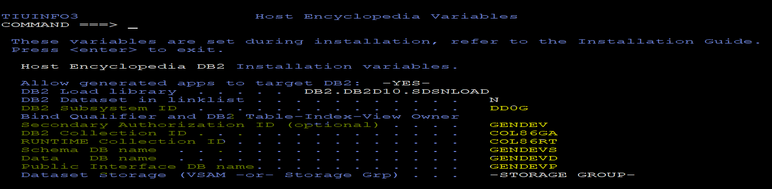

Select option 3 for Host Encyclopedia DB2 variables to determine the DB2 subsystem, secondary authorization ID, DB2 collection ID, Runtime collection ID, Schema DB name, Data DB name, Public Interface DB name:

The Host Encyclopedia databases to drop will be the Schema DB name, Data DB name and Public Interface DB name found via option 5.5.3 for the Host Encyclopedia DB2 variables.
