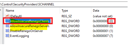

The server had registry key \HKEY_LOCAL_MACHINE\SYSTEM\CurrentControlSet\Control\SecurityProviders\SCHANNEL\AllowInsecureRenegoClients defined and set to 0. This causes a conflict with the third party library the RDP Proxy service running on the PAM server uses to establish secure connections.
The problem is expected to be fixed in PAM 4.1.7+ and PAM 4.2+. A hotfix is available for 4.1.5 on request.
As a workaround, if your security policies allow it, delete this registry key, or set it to 1. The RDP client on the PAM server will establish a secure TLS 1.2 connection using strong ciphers.
