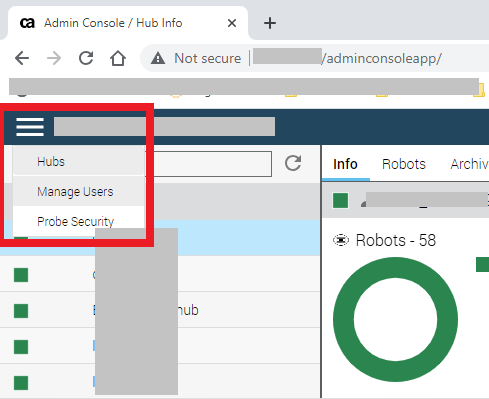

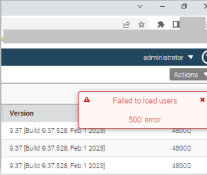

When trying to open the Manage Users and Probe Security pages from the SHOW MENU of the Administrator Console, we got the error message :
Failed to load users / Failed to load probes - error 500
It's working when selecting Hubs.
