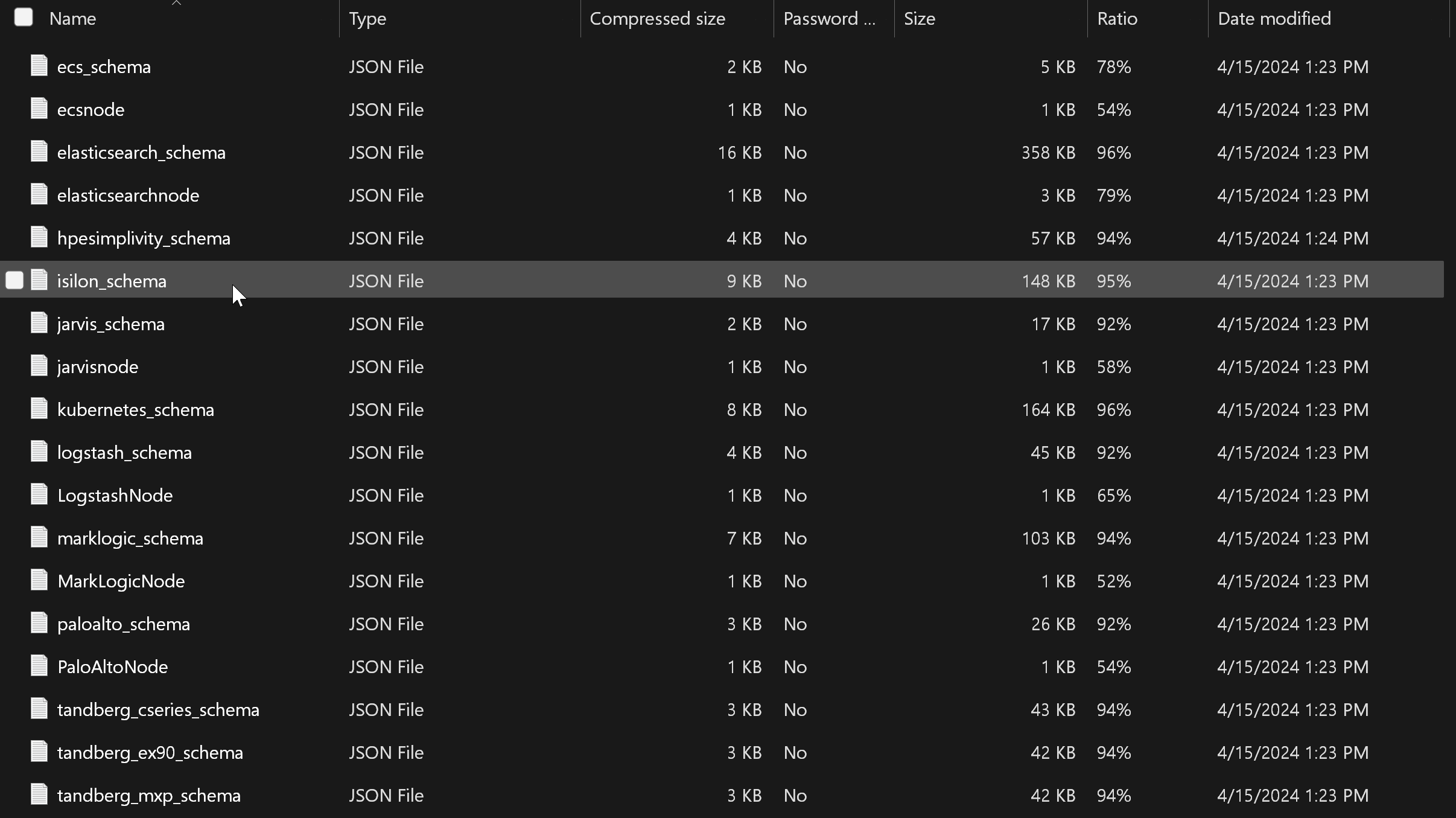

Extract the isilon_schema.json file as you'll need to upload the .json not the zip.
The schema json file must be named with _schema.json so that it's recognized when uploading it through the Operator Console. Examples: isilon_schema.json, elasticsearch_schema.json, etc.

Make sure the restmon probe is in the local archive. Extract the isilon_schema.json file as you'll need to upload the .json rather than the zip. The schema json file must be named with _schema.json so that it's recognized when uploading it through the operator console. Examples: isilon_schema.json, elasticsearch_schema.json, etc.
