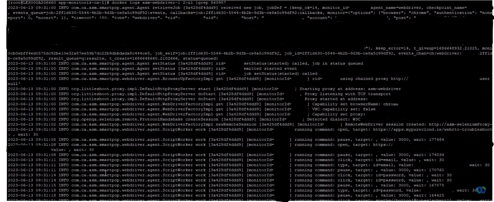

Wedriver scripts are not working with latest version of OPMS version OPMS 2023.3.6
Verifications:
1) No issues in services, all seems to be up and running correctly
2) No issue in nginx
3) No issue in webdriver log
4) Connected to webdriver pod and check connectivity to monitor, looks correct:
5) Proxy configuration looks correct in docker configuration
