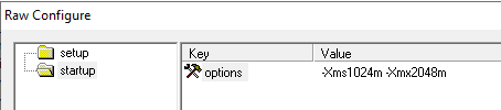

We increased the memory used by the maintenance_mode probe and restarted it.  Almost immediately, we started to see the alarms syncing to Spectrum.
From:
To:
The error messages in the maintenance_mode, ems, and spectrumgtw logs also stopped.
