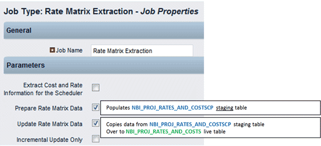

The 'Prepare Rate Matrix Data' parameter refreshes the NBI_PROJ_RES_RATES_AND_COSTSCP table with the most recent rate information. This may take a few seconds to hours depending on your data. During this time projects still have access to the rate information in the NBI_PROJ_RES_RATES_AND_COSTS table. The NBI_PROJ_RES_RATES_AND_COSTSCP is a 'staging' table that is only used to hold the data that is prepared. You only need to select this 'Prepare Rate Matrix Data' parameter after major changes / updates to the rate matrix have occurred.
The 'Update Rate Matrix Data' parameter copies the contents of the NBI_PROJ_RES_RATES_AND_COSTSCP table to the NBI_PROJ_RES_RATES_AND_COSTS table. This should take a matter of seconds to complete. The purpose of this option is to update the live table (NBI_PROJ_RES_RATES_AND_COSTS) with data in the 'staging' table (NBI_PROJ_RES_RATES_AND_COSTSCP).
