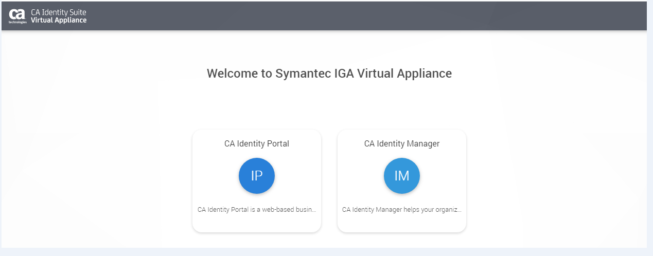

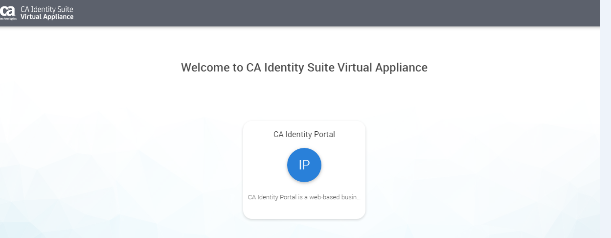

With the loadbalancer url in 14.3, we used to get only Identity Portal option.
After upgrading to 14.4, we get the option of Identity Manager and Identity Portal as well.
14.3:
14.4:
How to hide the option of Identity Manager?
