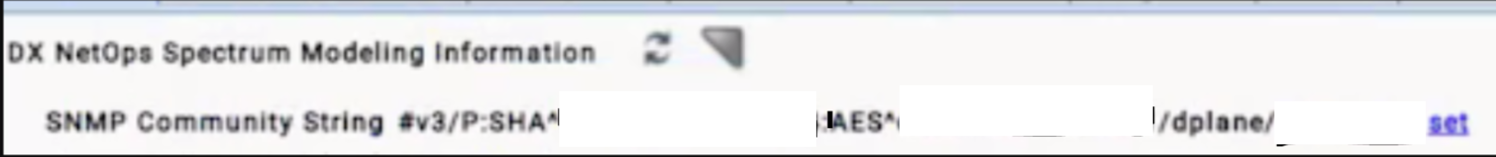

Add Context Name Information You can add the SNMPv3 context name value to be sent with SNMPv3 messages for a particular device. From 21.2.6, you can add a context name to an SNMPv3 profile while creating it. For more information, see the Context Name section on the Edit SNMPv3 Profiles Dialog page. Follow these steps:
  • Select the model that you want to modify, and click the Information tab in the Component Detail panel.
  • Expand the DX NetOps Spectrum Modeling Information subview, and click set in the SNMP Community Stringfield.
  • Add the context name value to the SNMP Community String field. For example, if the current SNMP community string is:#v3/P:authPass:privPass/myuserid
  • To insert a context name value of ‘quark,’ add ‘quark’ to the SNMP community string as follows:#v3/P:authPass:privPass/quark/myuserid

To clarify what we saw after getting this to work with discovery console
The sync of dplane context between DX NetOps Portal and DX NetOps Spectrum has been added in 23.3.4 under Defect DE567634 and user story US894561.  As long as the dplane has been added in DX NetOps Spectrum and DX NetOps Portal, nothing else is needed and a synch of the 2 products will consolidate both planes between the 2 products.
