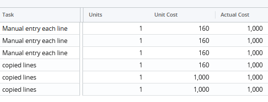

Transaction will look like this
Note the the first 3 are for task Manual entry each line. That means  each entry was created by adding a new row and manually entering data without copying.  All have the incorrect unit cost.  They should all have 1000 as the units = 1 and the cost I entered was 1000.
The last 3 lines are for the task 'copied lines'.  The first line here is the original entry done the same as the manual ones, but the other 2 are just copies of the fist line.  Those pick up the correct cost.  Is it because the value automatically populated from the matrix on the manual transaction lines and does not get overwritten when I type in the new amount?  But the copied ones already have the correct cost.
