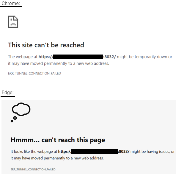

Users are not able to access secure sites on non-standard ports (i.e.  via Cloud SWG (formerly known as WSS) with the following access methods:
  1. Explicit proxy
  2. Explicit Over IPsec (Trans-Proxy)
  3. WSS Agent active with selective intercept
Getting generic error message ERR_TUNNEL_CONNECTION_FAILED in browser as follows

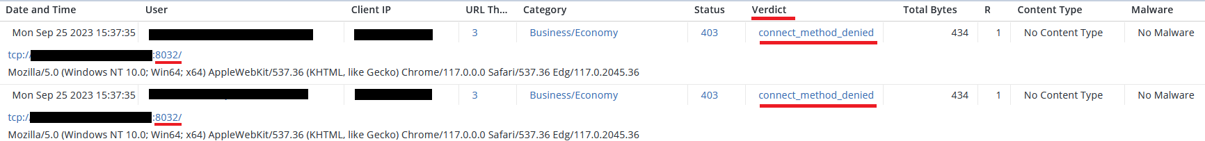

WSS Report shows Verdict as connect_method_denied.

When affected sources(i.e. Location, Client IP address, Subnets) or destinations(i.e. domain, Category, Web Application, Subnet) is added to the Content and Malware Scanning Exemptions Cloud SWG will basically disable protocol detection hence we can see request is getting denied at TCP layer (i.e. Refer to the WSS Report snapshot mentioned in the issue description). As soon as we remove it from the Content and Malware Scanning Exemptions request gets handed off from TCP layer to HTTP proxy and it gets allowed.
