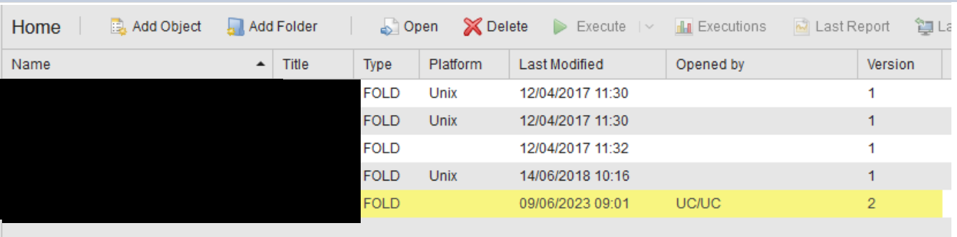

With this DIVDB_PK (that corresponds to the oh_idnr) we could then check in OH table what is the name of the folder and by looking into the table OFS find the subfolders related to it.

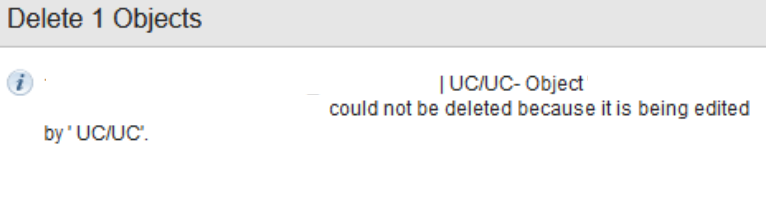

On this case, it was finally found and we then had an issue to delete the folder as it was being used by user UC/UC (5):

To delete the folder/s it is necessary to modify the OH_OPENUSERIDNR of the related OH_IDNR record and set it to empty, after that the folder/s could be deleted and the dbunload tool will not return any error.
In this case, this needs to be done on all impacted folders, not just the parent one.
