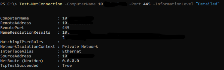

2- Check if port TCP 445 and 135 are blocked or not.
This checking could be done with powershell command like :
Test-NetConnection -ComputerName <computer_addr> -Port 135 -InformationLevel "Detailed"
Test-NetConnection -ComputerName <computer_addr> -Port 445 -InformationLevel "Detailed"
TcpTestSucceeded should be True :
