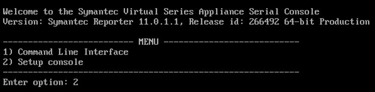

  • Power on the appliance (if it is not already powered on) and, when prompted, press Enter three times. When prompted with the boot menu, press 2 to open Setup console,
1. After you gain access to the console, press Enter three times to activate it.
2. Press 2 to enter the setup wizard and reset the password.
