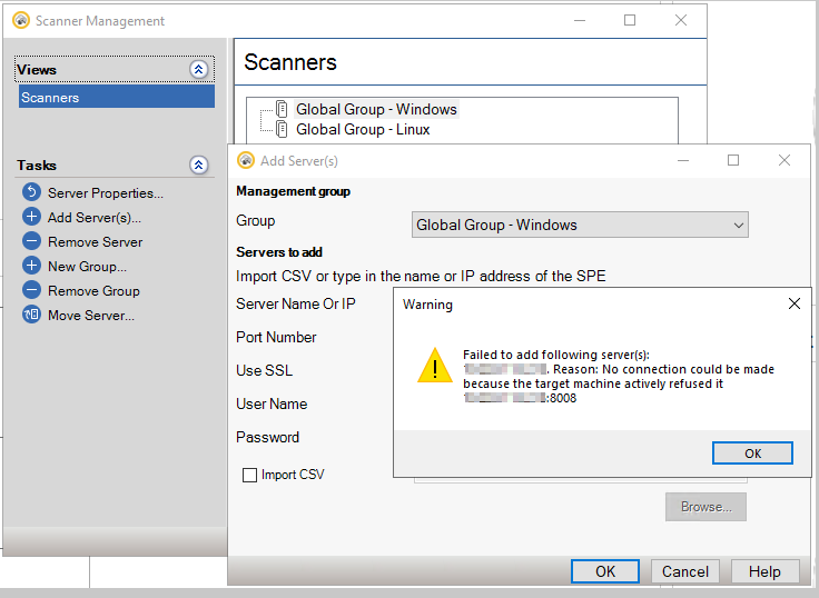

When trying to add a new scanner to the SPE 9.x console you get the following error.
Failed to add following server(s);
<IPAddress>.  Reason: No connection could be made because the target machine actively refused it
<IP Address>:8008
