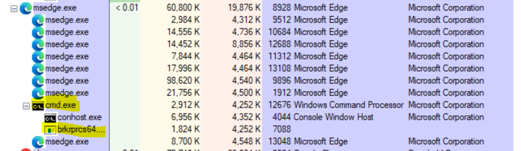

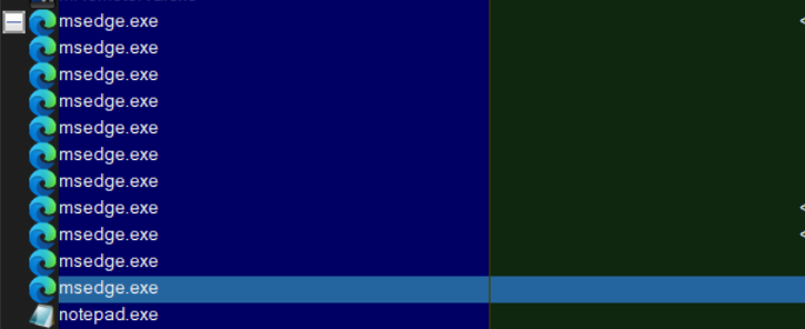

Check using process explorer if cmd.exe and brkprcs64.exe are running as a child process to chrome or edge as below.
Non working machine:
Working machine:
On non working machine, cmd.exe was renamed to cmd1.exe. Upon changing to cmd.exe, brkprcs64.exe started and unknown URL issue did not occur.
