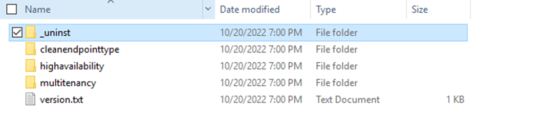

Comparing this problematic environment with a working test environment, the cause of this was determined to be a missing \CA\Identity Manager\Provisioning Directory\_uninst\ folder.
The _uninst folder had been zipped up in the past and the installation configuration settings could not be gathered from that folder by the installer.
After we unzipped and replaced the \CA\Identity Manager\Provisioning Directory\_uninst\ folder the upgrade found the correct installation folder on the D drive and the upgrade completed as expected.
