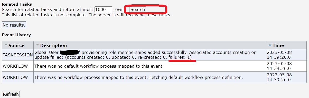

When trying to see the Cause of a failure in the View Submitted Tasks we see the message "This list of related tasks is not complete. The server is still receiving these tasks"
The expected message should be
All Identity Manager
Identity Manager has not received/processed the inbound notifications from the Provisioning Server related to this which means that information has not been added to the IM task persistence database yet.
This could be due to either a backlog of inbound notifications yet to be sent to the Identity Manager server, misconfiguration of Inbound URL/Password, or failures in sending the inbound notifications to the Identity Manager server, or because the sending of inbound notifications is suspended/disabled (which should not be set that way).

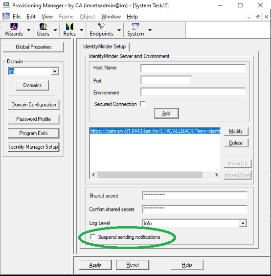

Be sure that the Host/Port/Environment and Shared Secret values are properly configured and also make sure that Suspend Notifications is not set as shown in the screenshot below:
To have the Cause information in the View Submitted Task (VST) you must un-check the "Suspend sending notifications"
