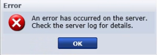

After moving the PAM database and re-configure to point to the new database server, the processes triggered from SDM are not running.
PAM UI shows the following error: An error has occurred on the server. Check the server log for details.
